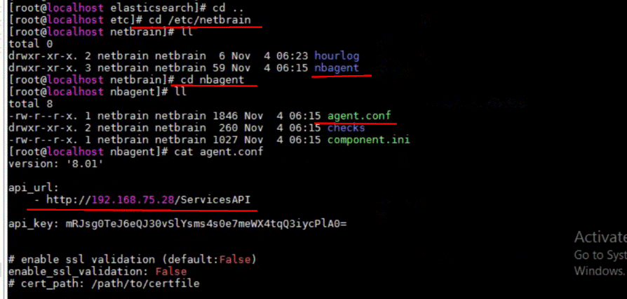

    On Linux server: If you keep the default directory, you will find the service monitor configuration under /etc/netbrain/nbagent. Please check the agent.conf file and check the api_url in it. Please figure out whether you are using HTTPS or HTTP, and the IP address of the web server or the domain name of the web server. Please pay attention to the format the api_url.
    NetBrain Tip: In some situation, if there's only the Linux server or the Windows server is displaying on the page, please use the displayed server's agent.conf as a reference and modify the other server's agent.conf file accordingly.

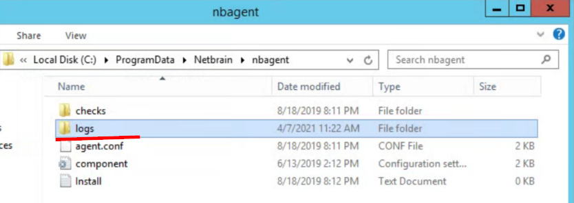

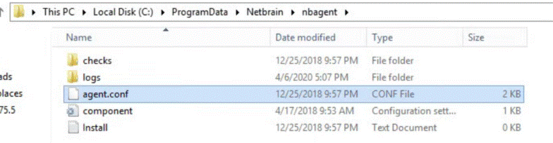

    On Windows server: You can find the agent.conf in the ProgramData folder, which is a hidden folder.

    On Linux server:
    systemctl restart netbrainagent to restart the service monitorsystemctl status netbrainagent to check the status

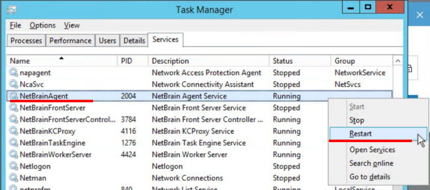

    On Window server:
    Go to Task Manager or Services to restart NetBrainAgent.
    Then, please wait for a few minutes and refresh the Service Monitor page to see whether they are connected or not.
